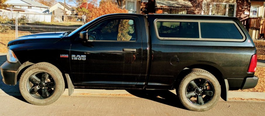

I have a 2015 RAM 1500 2wd, 5.7L non power. I think they call them the ST. Its fun grocery grabber I put about 3500km a year on and we are slowly doing things like exhaust and have the cam and headers sitting here for when we go past 200k on the motor (its at 101k right now).
Can I take the stock doors off and buy a set of power doors from a salvage and put them on? Will a wiring harness exist to just plug and play? If not, does it just need a hot wire to make the mirrors articulate and fold, and windows crank?
Thank you for your time.

As long as they're off another regular cab truck.The doors on the 2 door regular cab trucks are longer/bigger then the doors on a quad or crew cab truck.The interior door panels are also longer
That is good info, there are two quad cabs locally with the same color. This is going to be a little bit harder now, narrowing my search like this. Thank you for your time.

The 2 door trucks are the oddball when it comes to doors :waytogo:
