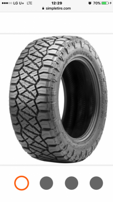

Check out the hybrid AT/MTs like the nitto ridge grapplers there more an AT with a MT sidewall to look aggressive.

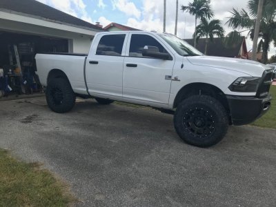

^ Can ya get one from the front so he can see how much the tire sticks out?

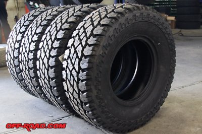

I ran a 35 x 12.5 ST Maxx on my truck prior. Very nice tire, looked good and wore well. A little more noise then your typical AT tire but way less then some of the mud tires I've heard. With a 1.5" level nothing rubs.
