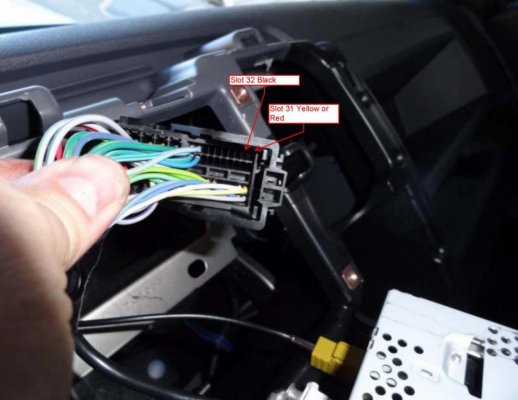

Master tailgaters handle with built in camera for 2017 ram 1500. And a female rca with 2 pins on the end of the yellow/black wire coming out of it. Removed Yellow/black wire from the included plug that came with the rca female end. Plugged those 2 pins into pins 30/31 of the uconnects harness.

Master tailgators camera used:
