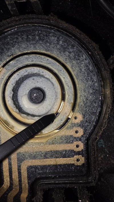

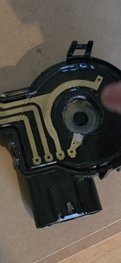

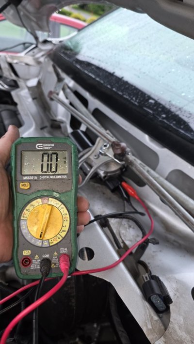

- Internal park contact ring was visibly worn through in one localized area
- Contact ring repaired/resurfaced
- Motor housing ground tested good

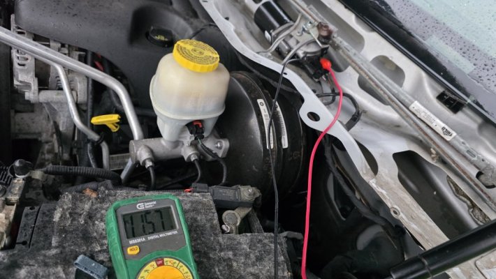

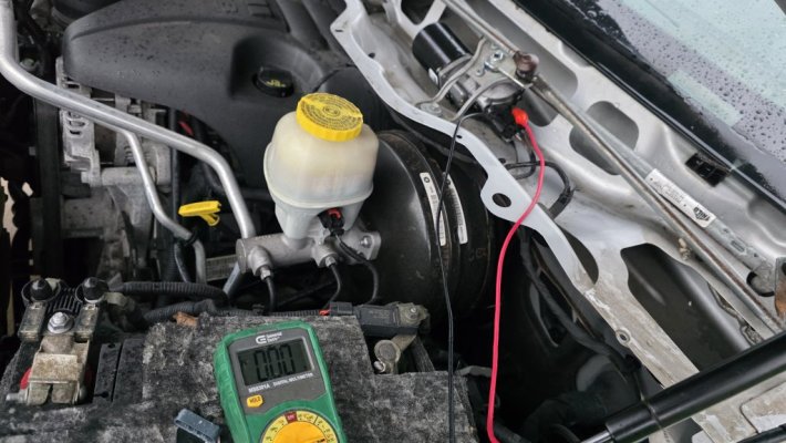

- Park signal continuity tested successfully between pins C and D (continuity in park position, no continuity outside of that position)
- Park signal voltage tested successfully during live operation.
Motor testing results:
- While wiping, the suspected park signal wire shows battery voltage.
- When the wipers reach park position, the signal drops cleanly to 0V.
- This behavior is repeatable and consistent.

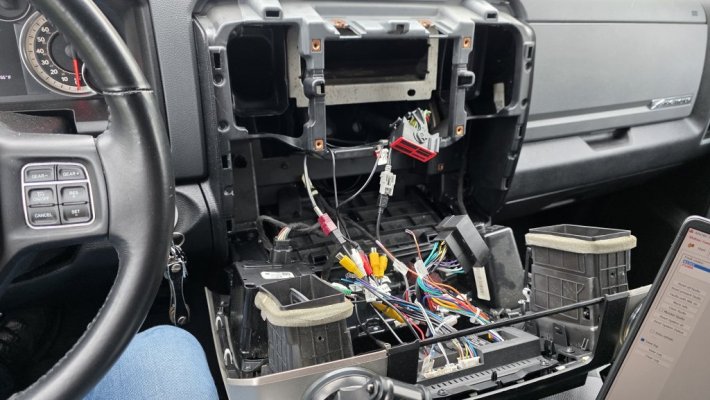

- Truck has an aftermarket Android radio installed using a CAN BUS adapter/interface.
- I still posses the OEM radio and intend to install it on suspicion of potential CAN issues.
- I do NOT remember whether the intermittent failure started before or after the radio installation.

Disconnected the aftermarket radio and CANBUS adapter. Symptoms unchanged.

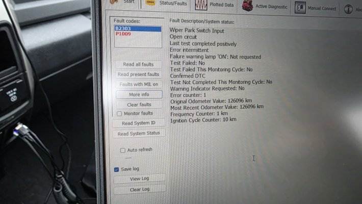

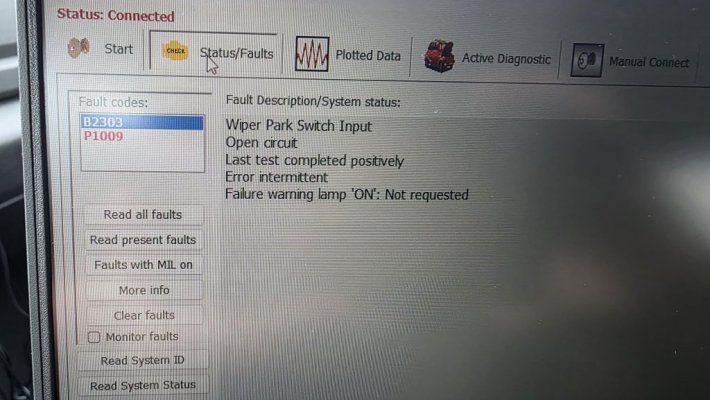

UPDATE:
My OBDLink MX+ arrived much earlier than expected.

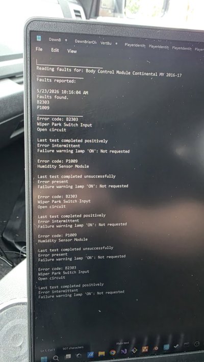

AlfaOBD reports B2303 in the Body Computer: MY2016+ PowerNet
Log appears to describe that the issue is intermittent, yet the existing 3 log entries show that the test passed in the previous 3 attempts (likely this was due to my earlier stated repair of the worn through contact surface.)
I will try resetting the code to see if perhaps the module will attempt to wipe afterwards.
UPDATE:
After clearing the fault, I left the wipers on intermittent mode for 10 minutes. The symptoms are still present, but the fault code has not reappeared. I then left them on LOW continuous mode for 5 minutes, symptoms unchanged, fault code has not reappeared.
this appears to indicate that my contact surface repair worked. But the symptoms for failed intermittent mode continue to exist.

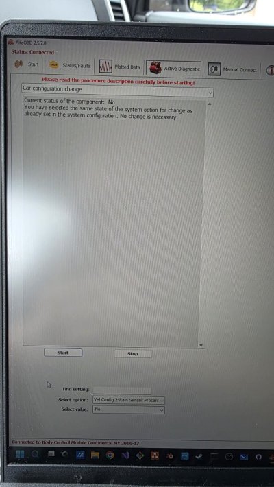

FAILED HYPOTHESIS:
I suspected that Rain Sensing may be enabled, that the truck was waiting for a signal from the component (which does not exist.) But on trying to disable it, I found it was never turned on.
UPDATE with new AlfaOBD results:
I changed the ECU type to Body Computer: MY2018+ (despite this being a 2017 RAM), and was able to test the following components under Active Diagnostics:
Front Wiper (High/Low)
Front Wiper (On/Off)
On/Off actuated the wiper motor, continuously.
High/Low showed NO actuation at all. The motor did not respond to the input in any way.

Symptoms were:
- Intermittent wipers would only wipe ONCE
- Low and High worked normally
- Increasing interval upward always triggered exactly one wipe
- All intermittent positions behaved identically
- No BCM fault codes were present
What I tested during diagnostics:
- Replaced wiper motor
- Verified park signal operation
- Repaired damaged motor contact trace
- Replaced wiper stalk/switch
- Removed aftermarket Android radio + CANBUS adapter completely
- BCM diagnostics with AlfaOBD
- Active diagnostic tests
- BCM system status monitoring
- Verified low/high operation
- Verified washer input recognition
- Verified all intermittent positions collapsed into the same BCM interval state
SOLUTION FROM IMPORTANT DISCOVERY (discovered by reading the service manual):
My truck physically HAS the LRSM/rain sensor hardware behind the mirror, even though I originally believed it only had the ambient light sensor for automatic headlights. This setting was DISABLED in the BCM, as if it did not have rain sensing.
The BCM configuration turned out to be the issue.
The fix was:
1. Enable all LRSM / rain-light sensor related settings
2. Disable:
“Cust.Prog.Features-Auto Wipers”
After cycling ignition and retesting:
- ALL intermittent positions now work correctly
- Delay timing changes properly
- Rain sensing now functions correctly
- Slower intervals also work normally
- Speed-sensitive wipe can now be tested properly
At this point, the issue appears to have been a BCM configuration mismatch involving the LRSM / auto-wiper logic, not:
- the motor
- wiring
- the radio
- or the stalk itself
Hopefully this helps the next person chasing the “single wipe intermittent” issue on a 4th gen RAM.
I will edit this solution into OP for future viewers with similar issues to quickly check the same things that resolved it for me.
PS- The aftermarket radio is not interfering. Wipers continue to work with it reinstalled.
