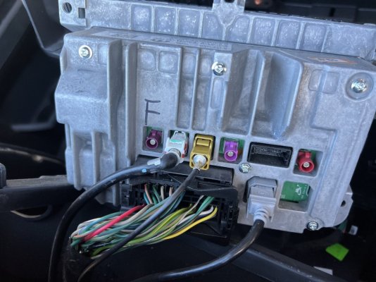

That mustard colored plug on the radio is both SXM and GPS. If reception is poor and GPS isn't working, I'd bet replacing the Antenna would fix it (I fixed mine that way). Conversely, you could try updating the firmware on the radio to see if it's a software glitch.

The pigtail of wires on the back of the radio should be secured with zip ties. Lose connections sounds like a loose wire someplace.

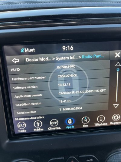

@SitKneelBend is there a cheap DYI antenna I can connect on the back of the unit to prove the antenna is bad ? Where can I find the latest software for Canadian UCQ W/NAV 68331632AH. It’s at 18.42/22.6 currently.

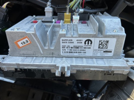

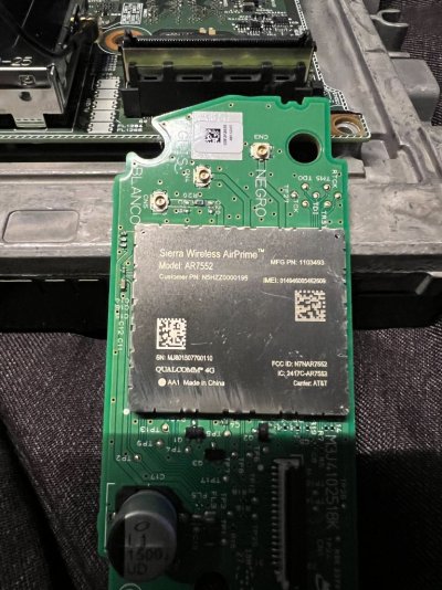

FYI the Canadian version UCQ 68331632AH also has the Sierra Wireless AirPrime AR7552 card like the US version. Looking into replacing it to see if it will fix my 0 satellites issue. IMG_3988.jpeg
