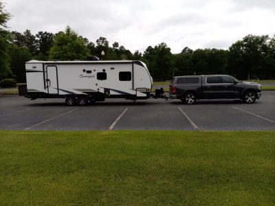

We have pretty much the same truck. With a slightly higher payload at 1390. Our travel trailer is bigger and longer at about 6400 loaded and a hitch weight about 750 lbs and 31.5 feet long.
I have an Equal-Izer hitch 10,000/1,000. I am happy with the set up. It tows great and no sway with 18 wheelers going either direction. And the truck and trailer are pretty level.
We do not travel with water, waste or fresh. How about you?
I have nothing in bed of truck like you except for some lawn chairs. War Department, myself and Stella the Rottie take up most of what is left of payload as you have seen.
I keep the pass thru storage filled with very lite items. My tool bags and boxes, I keep in the trailer on the floor in the back until we get to our campsite. Then move them to the bed of the truck. I also have a Storage Rack in back of trailer. Which is supposed to support 300 lbs. But is barely carrying 50 lbs now.
Hitch set up is the most important thing. I had 2 dealers screw it up. I finally worked on it myself and that helped and found a dealer that knew what they were doing. The second time LOL.
Good Luck and if you have any questions about my setup, glad to answer. I will post some pictures later.

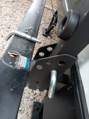

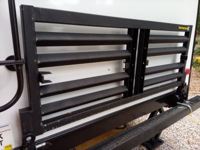

FYI. Not an expert on trailers. But I have seen posted on RV forums that Receiver hitches on the back of trailers need to be attached to the frame not the bumper.
This is a storage rack I have from Lippert. It bolts to the frame and no receiver hitch required. Unfortunately this one is not sold anymore. But they offer a smaller capacity one
Have fun!.
Have fun!.
Thanks. That's a great setup you have on the back of your trailer. I have read lots of horror stories of folks attaching hitches, bike racks, carriers, etc. to the bumpers, and the weld breaking loose dumping everything behind the trailer! I've been planning on installing a Curt receiver hitch that attaches to the frame.
