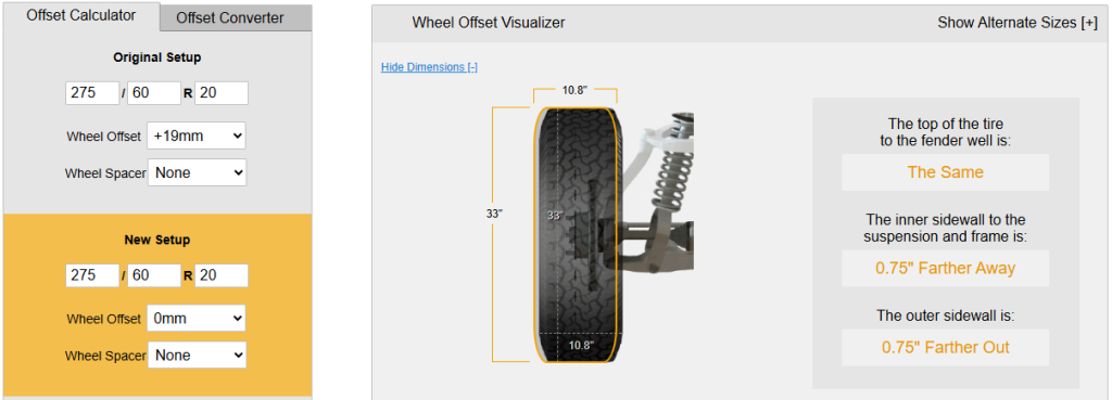

A 0mm offset rim would give you a bit more of a wider stance on the stock tire but not much. Stock offset on the OEM wheels is +19mm. So going to a 0mm wheel on the same tire would make them stick out about .75" more. See below for a better visualization.
https://tiresize.com/wheel-offset-calculator/

Spacers or different wheels. I'd recommend different wheels. 0 offset is not going to give you want, you need -12 to achieve 1.2 inches +/-.. (19 +12)/25.4
So anything between 0 and -12 should work. But if you want exactly an inch you are looking for -6 offset.
