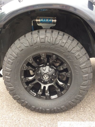

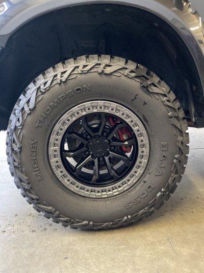

I wasn't gonna bring this up , but I totally agree, I always run the smallest rims that will clear the brakes
And personally, I love seeing some sidewall on a tire
I like more tire than wheel too,
I bought my truck with 20” wheels, than switched to 18” x 9” but not enough offset so had to use 1” wheel spacer.
I have 17” x 9” now, no spacers, definitely my favorite setup between the three.
now those look like truck wheels
