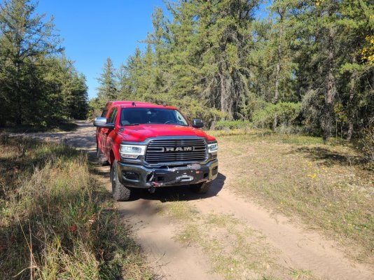

Photos below red truck, 16 laramie sport 33s, on factory 20s +18 no lift 1.4 level in front.

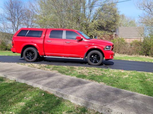

white truck. 24 warlock 315 70 17. 34.6 x12.4. X 17. Factory 17 +18 10 mm spacer making offset +8. No lift, factory 1.4 level in front
