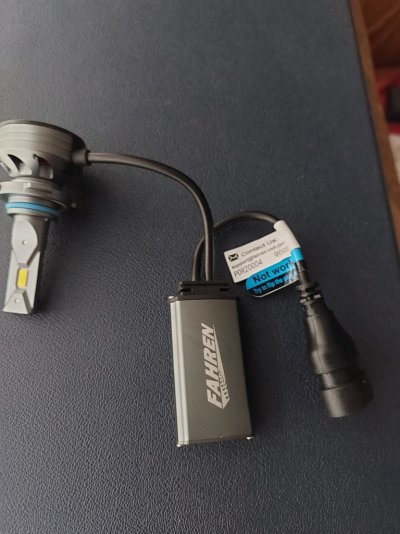

The only thing that comes to mind is that if the OE incandescent Halogen headlight bulbs were upgraded to aftermarket LED bulbs, the incorporated cooling fan in the base might be approaching failure.
