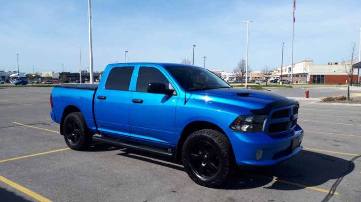

19' with front and rear 5100 Bilstein; fronts set at 2.1" raised and stock springs on all four corners. I still have a little front biased rake which I wanted because I occasionally tow or haul generators.
This pic I'm on my LT285/65R20 BFG KO2's. I'm now on LT295/65R20 Michelin Defender LTX M/S tires and I am much happier with the ride and performance (especially in rain).
Yes, I miss the more aggressive look of the BFG's. But I now have a slight additional increase in height with the Michelin's, and the Michelin's are about 5lb a tire lighter even though they are bigger, and they balanced out between 0.75oz and 2.5oz per tire, whereas the BFG's took between 7.25oz and 10.25oz per tire.
My new tires are equal to 35.1" OD (at least that's what their specs say...lol), and I have zero rubbing or turning issues. I can go full stop side to side in forward or reverse and have zero rub (the same with my old BFG's, too).
