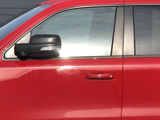

Here is the best i can get. Excuse the dirt running down from the window. she needs a bath. IMG-0538.jpg

You may want to take it to a detailer or a local body shop to get an opinion. It might save you money in the short term not having to buy tools, polish, etc. Hard to say how deep the scratches are from the pic. You could invest in in a YiFeng Clip on 60X microscope for your smart phone or a Carson 60 to 75X Micromax LED microscope for a small investment to tell how deep the scratches are before attacking them. Both of the products mentioned are available on line. If not these brands then something similar. Good luck.

Here is the best i can get. Excuse the dirt running down from the window. she needs a bath. View attachment 485361
Post a picture as close as you can get it ... from that distance it looks like a very bad hologram ... try to get some like inches away and from both angles and then directly in front please ...
