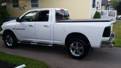

Hey guys! I know this question has been beat to death but I still can't find a clear answer so I figure if I can't find it here I won't know until I install lol
Here goes.. I just picked up bfg ko2s 305/55/r20 yesterday for my 2012 big horn 4x4 I have a rough country 2.5 leveling kit and stock rims.. are these tires going to fit on stock oem rims? And am I going to get rubbing on my control arm or anywhere else??

33" tire about 12" wide? Shouldn't be a problem.

I have that size on my stock 2010 Laramie

Pictures?
