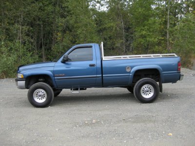

Thanks for the pointers. Also, nice rig, Head Lice! What brand of fender flares are those? They look perfect.
