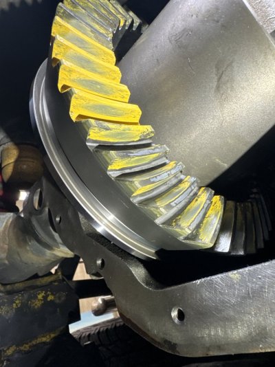

Paint up pics from current setup.
Pinion shim .024”
Pinion preload 16 in/lb
BL .010”
Noise between 45 and 55.
I’m picking it up today and putting a generic chassis ear on it to see if the noise is coming from the pinion or the transmission output.
They are giving me the option to re-install my factory gears and carrier if I still think the noise is coming from the rear end.

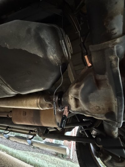

Put the chassis ear on it with a pickup on the tail shaft of the transmission, one near the carrier bearing on the side of the case, and one right on the front of the diff near the pinion yoke.
The shop said “everyone involved thinks the noise is coming from the transmission”. Nothing from the pickup on the transmission. Gear whine is audible on the carrier bearing pickup, but is very pronounced on the pinion pickup. 100% where the noise is common from you can flick it on and off as a quits as soon as you lift the accelerator and the pinion isn’t loaded.
Based on all my reading my assumption is that it is losing the preload on the pinion bearings.
They have my stock gears, and are offering to refund my money and install stock gear and carrier. I think I’m going to go down that path and either find another shop, or tackle it myself. Or see if I can junkyard a 4:10 rear.
I don’t want to drop the carrier and check the preload now, once I open that thing up I’m stuck with it. Much harder to get them to refund me when they can blame me. If I do it myself I’m ordering REM polished gears and using a crush sleeve eliminator.
