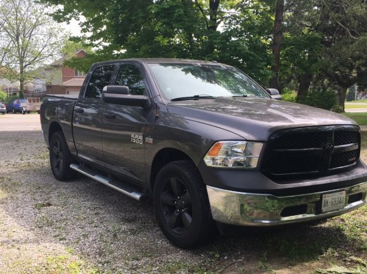

I posted picture for reference but I believe it would be the express.
yea those are from the express....they are 20x8

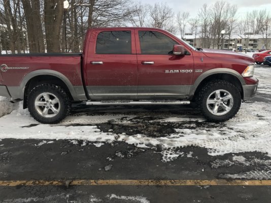

These are Firestone Destination MT2s 35x12.50R20 on factory wheels. I’m running a Supreme Suspension 2” spacer. I had to remove the splash guards because the tires rubbed on them now I have no issues
