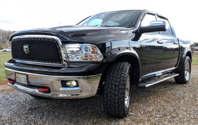

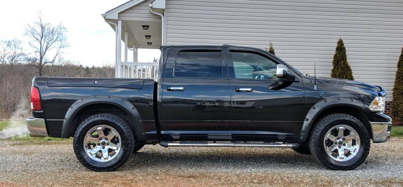

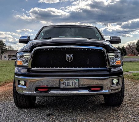

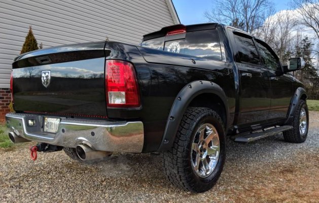

Adding to the thread. New shoes installed today.
2.5" front level, 1.5" hubcentric spacers, stock shocks for now, stock 20x9 chrome clads.
Tires are 35x12.50x20 Nitto Terra Grappler G2s
Extremely pleased with the result over the ATs I was running previously. These fill things out and do wonders for the stance even on stock wheels.
Only a very slight rub on the driver side wheel liner, otherwise ALL CLEAR. May torch it or take the Dremel to it this weekend.8273153578000ce02bd974682d4ee89e.jpg825ae1e1728afd934b888fbe947c5a64.jpgbd96be5cf209326eb556b8d53c833706.jpg18ae3a6b6e99c6b980c87632d4046c79.jpge17844d360b09f7311c032a314e7a6f8.jpg

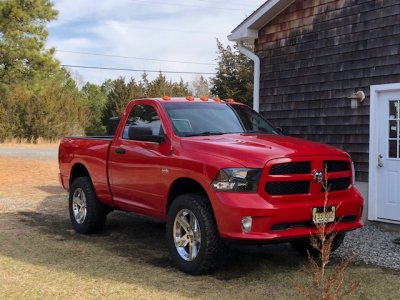

Very nice looking single cab I wanted to know did you have to drill into the roof to put the lights I really wanted to do that to mines
Single cab sure would make for a much easier headliner drop!! rofl
Yes I did . They are OE MOPAR lights , comes with template. Each light required two 1/4" holes and a ......I forget now if it was a 5/8" hole between the 1/4" holes for the light socket and wire. A step drill makes this a piece of cake to do . No extra sealant just the way the factory would of mounted them and no Leakes. As far as the headliner goes I only took console, visors and A miller out and the headliner dropped far enough to get the job done . I probably did 5 Rams and about 6 other brand trucks , never a leak. I preferred the amber lens which is plentiful on eBay
