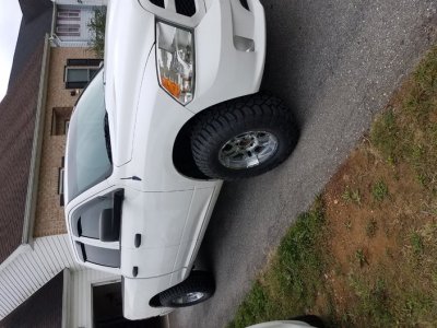

Heres a picture of them!

Made a little progress on getting the bedliner off the wheels. Used aircraft stripper,scraper,and a wire brush on an electric drill. Hopefully installing the Bilsteins within the next cpl weeks then I just need to get tires.
B
Bettywhite
Sep 26, 2017
11
Ended up going 2.8 on the Bilsteins. I love it! 35/12.50R18 grabber x3's. I love the look but damn did my power go down. Might be time for some power adders.
B
Bettywhite
Sep 26, 2017
11
Thank you! It will look alot better once I paint the wheels.
