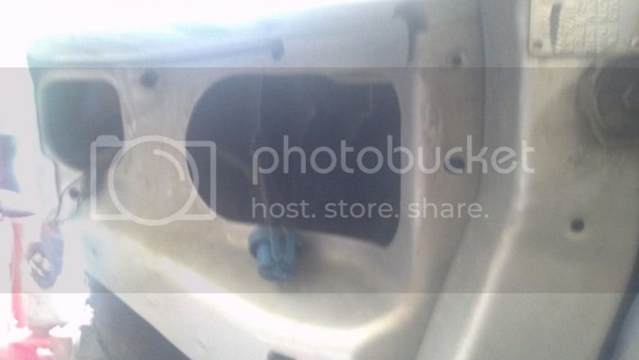

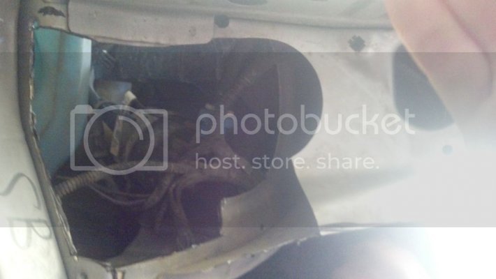

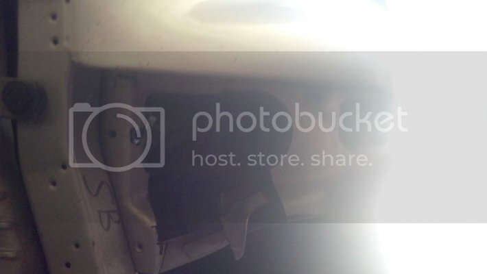

Now, you should be looking at your stock headlight mounting supprots that are built into the fender, they gotta go....so take a good look and say good...

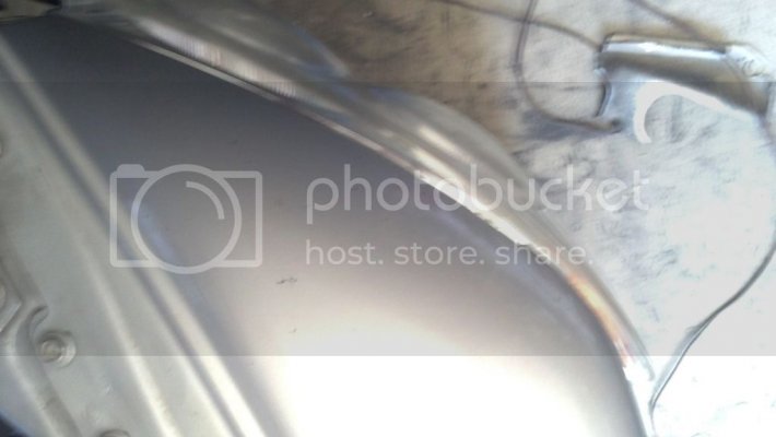

this is done by carefully holding up the light, and looking to see what needs to go, i'll give you a hint, all of it....

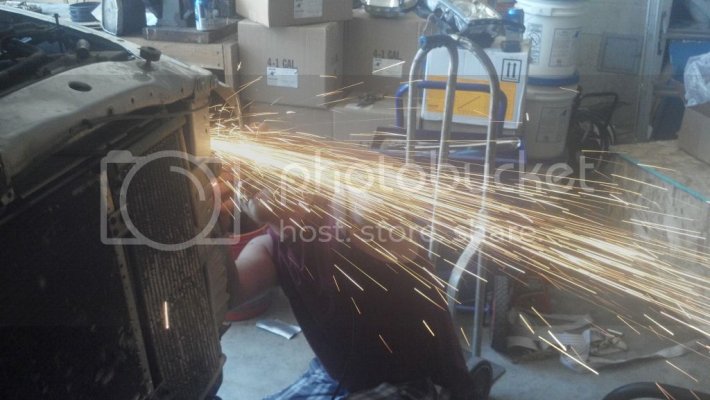

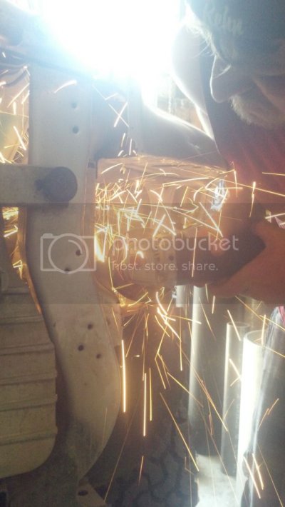

take your time, make small cuts on your first side, that way you don;t take to much, and be careful not to grind or cut your fender as you are right next to the actual fender skins...

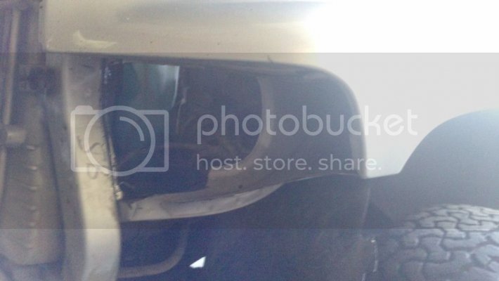

now that you think your close, lets test fit it again....
and hey check that out, it finally fits after a TAKING YOUR TIME TO CUT AND TEST FIT.....

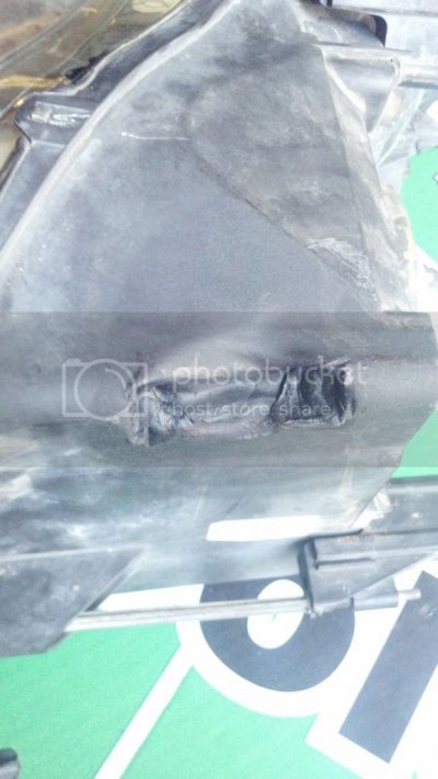

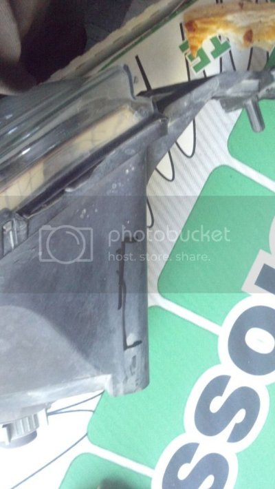

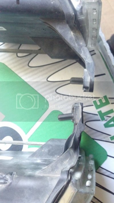

wait a second, it doesn't quite fit perfect, but its close. and you have cut and ground the metal all the way from the core support to the fender...what to do now? well, since we cut up our perfectly good fender, why not modify the light housing? To get it around the core supprot you need to melt in the inside lower corner because it hits against the core support...we used a specialty screw driver that had a socket on the end so it was nice and round. so take your time, heat it nice and slow, and once it is nice and soft slowly press it in. you don't need much, and it would be better to do this twice, than to screw up your housing...so take your time...
alright! sweet, now that doesn't interfere, and hey look, it slides in perfectly and the top mounting spot eve lines up with a mounting bolt into the core support, isn't that nice, but it is pretty far out....and the grill on the hood won't close...damnit.....time fro more modifications. back to the heat gun and a pair of channel locks. Heat the mounting bracket supprots. the parts that come out, have the vertical supports under the horizontal piece for stability, heat from the bottom. with the channel locks slowly bend it down once it is soft enough to move without braking.....take it nice and slow. you need about an inch or so, but again, better to do this twice than brake something. Also while you do this, make sure you keep the mounting wholes straight out so the bolts will go straight through, and not be sitting at an angle when its mounted. When this is at the right angle it should sit in against the core support mounting bracket that lines up.....

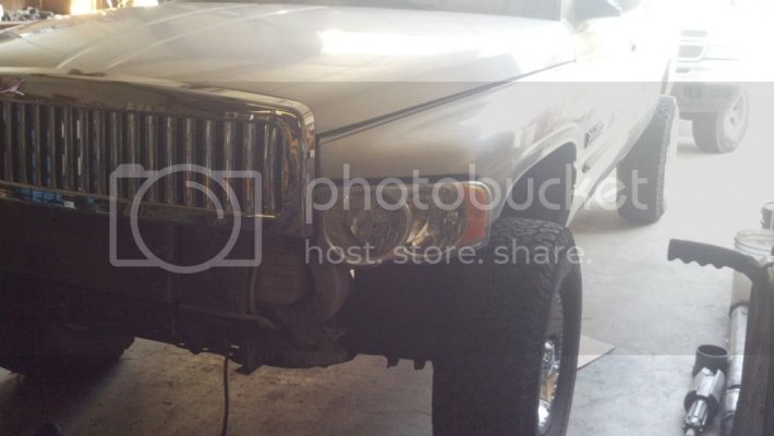

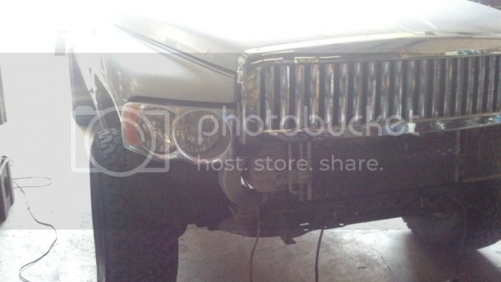

repeat on the other side, and than you should be looking at something like this....
so now its onto the bumper. I will show you what i did, but you will need to figure out your own bumper since i don't have a stock bumper any more.....
i lined it up, and cut it to where i would have clearance, nice and easy. except for it being so freaking heavy......

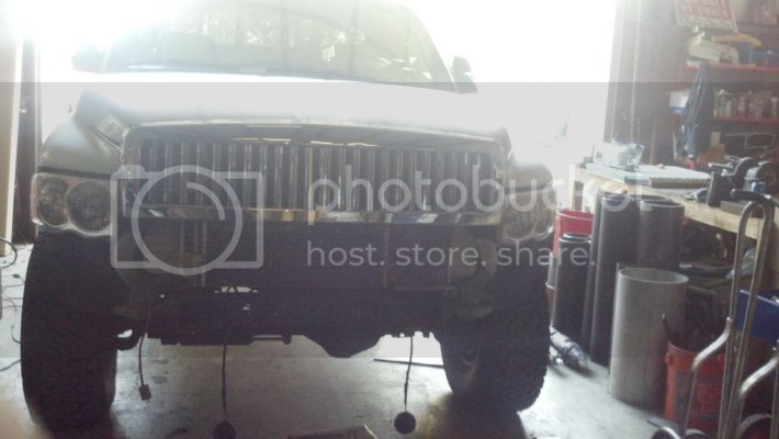

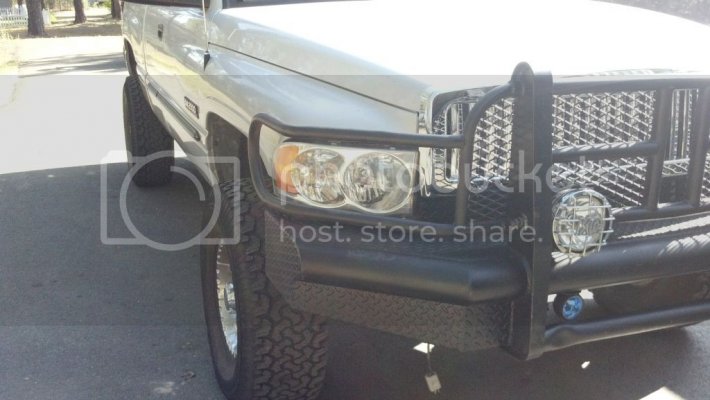

lined it up again, and perfect. mounted everything back on...and now i have 3rd gen lights on my second gen truck, and freaking love them. hope someone else follows suit and can help improve the walk through. This is something that takes alot of time, and effort, but it worth it. You also can't go back to the stock lights, so you better like these more, otherwise you need new fenders.....

I haven't driven it at night yet, but i know they can't be worse. lol. And yeah, in order to get any better fit its hacking up the core support which i wasn't ready to do. and by the time i knew that, i was well past the point of no return. lol but once i get some fender flares, it'll look better, but there will still be excess further up in front....

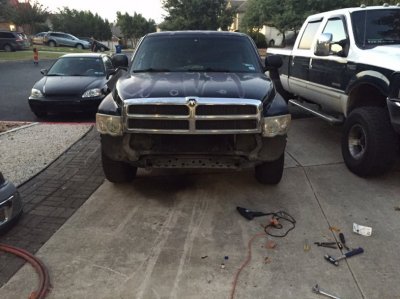

In case anyone else 3 years down the road decides to do this. it can be done!

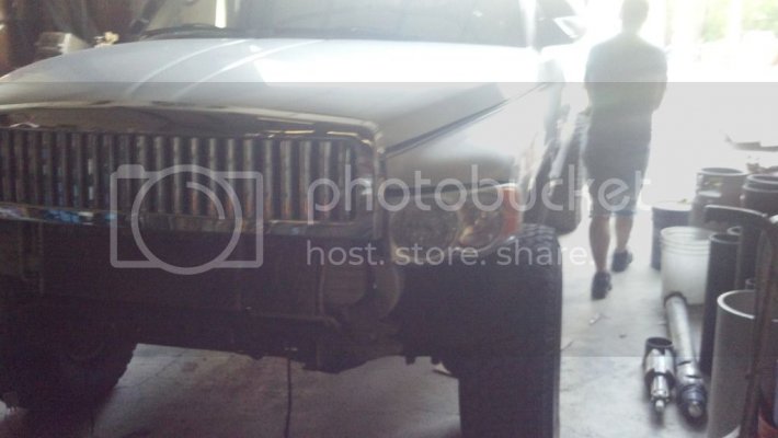

Here is more pics for you future folk!!!:favorites13:

for the most part I followed your guide, there was a few spots I was unsure. but once you start you finish!
I used an angle grinder and took it easy on the first side(passenger for me).
I also used a dremel for those hard to reach areas. I had to sand down the turn signal light bulb connector as it wouldn't fit correctly in the 3rd gen headlights.
It took about 7 hours Monday for all cutting, fitting lights, and drilling mounts, and 3 hours today to make "adjustments" on the oem bumper, Cutting the steel was easy trimming the plastic was the more difficult part.
I also only have 2 mounts on the headlights into the core support , I do not have the bottom mount yet.
I drove it 55 miles today at highway speeds and took it through the car wash, without the front bumper.
The lights stick out a tad like yours, I mainly tried to line up top fender and top light. I didn't worry about the fender curve to much.
I was able to save two of the original mounts for oem headlights, The ones by core support.
Overall I am happy with them.
Putting grill guard back on tomorrow.
