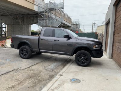

My Pleasure. Your truck looks a lot better. @hodge-xj we may or may not have put a test wheel and tire on that just happened to be here for ceramic coating at the same time4FB9A01E-D299-4935-BE86-AA4B50DBD6FC.jpeg
Angles are good and alignment went smoothly

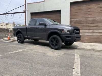

I’m thinking toyo open country mt 35x12.5 not sure about wheels

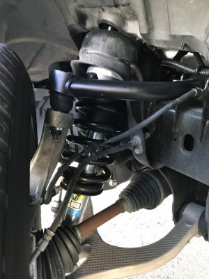

I think it’s better than stock honestly . I guess because of the bilsteins or maybe it’s in my head.

I assume you do the Bilsteins at the same time then? Did you put Bilsteins on the rear?

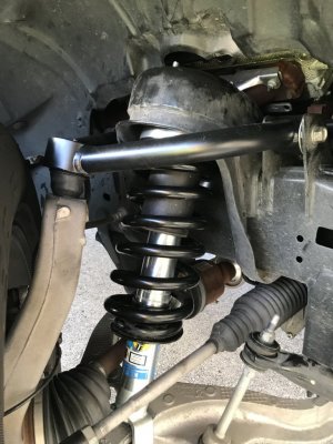

4” lift kit has front and back spacer and I had already purchased the bilsteins for when I was planning to just do a level. As mentioned before they are set a 0.

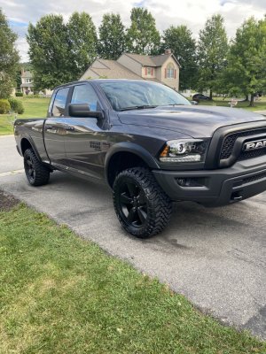

updated with tires
33/12.5/20
Toyo open country M/t
These tires have a serious sway so far, almost feels like I just have a centered ball bearing on the ass end and it follows whatever I do on the front. Might have to change to something else .

I consider it a hybrid I have it on mine too with front and back Bilstein's. You get new UCA's and new rear shocks ( I added new front ones too) but it does utilize spacers in the in the back and front instead of a full suspension lift.
I would say this kit is good for anyone who drives 90% on pavement and is content with the amount of off road a stock ram suspension could handle.

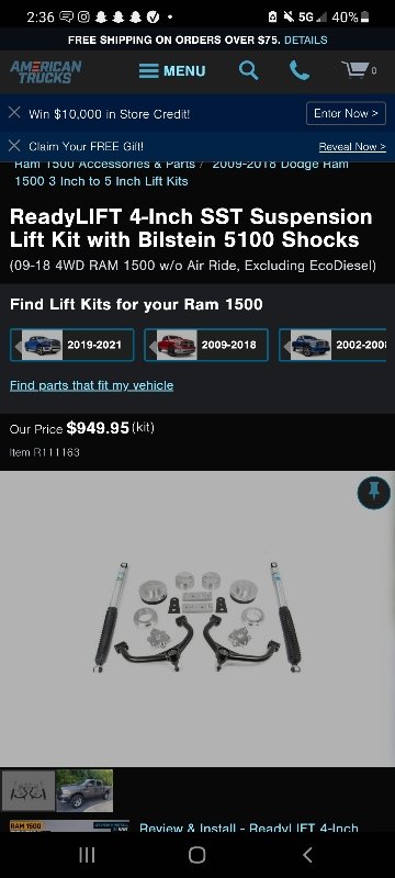

The price point is what sold me.... 2500 installed for zone BDS or 1700 for readylift sst installed.
I have 0 complaints about mine. The ride is great and as another member mentioned the kit is reversable.

I'm thinking of going with this ready lift route, my question is if I already have the rear suspension lift parts from another truck are you guys aware if any kits that include the ucas sway bar drop brackets and front spacers? I tried to contact ready lift to individually purchase the pieces but they are only sold as kits, any help would be great!
