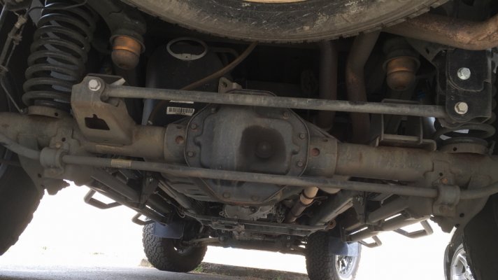

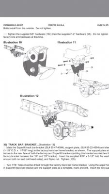

My 4” Superlift came with relocation brackets for all of the rear components and 3” coils
According to the instructions and Parts list on Superlift website only the 6” kits get these relocation brackets, 4” kit doesn’t show these parts on the Parts list nor the instructions.
post a pic of yours I’m curious if their instructions are incorrect and outdated.

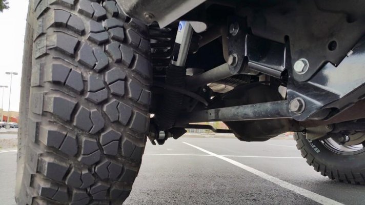

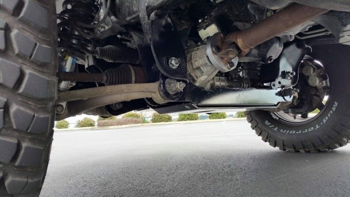

I wanted to lift my old 12’ 1500 shortly after I got it but didn’t want to toss my warranty out the window either. Went to my Ram dealer and they told me that they could install a 2 1/2” Mopar Level spacer kit, or a 4” Mopar Suspension lift. Parts and labor about $6500 out the door. Yeah, no lol. Got the lift part number from Their Mopar parts catalog and found the lift (Made by Superlift) online for $1850 with Bilstein shocks. I talked to the service manager and asked if I had the kit installed would my warranty be void? He said as long as it’s got a Mopar part # it can be warrantied. Had the lift installed and 6mo later my steering rack goes bad. Took it into the dealer and they tried to tell me its cause of the lift and they can’t fix it. Brought me a big stack of papers stating that if the vehicle is altered they can’t do warranty work on it. He highlighted the part where it said that. The line right under where he highlighted clearly stated “excludes authentic Mopar accessories” well guess what! My lift matches the Mopar part # so I got my warranty work done! Lifts and warranties kinda vary by dealer... as far as turning a 4” into a 6”, you can’t. The drop brackets are different sizes, so are the spindles, and front spacers, rear coils, etc. What you can do, and what I did,is get the kit that comes with Bilsteins and adjust them to 1.4. After installing them at 0” the front was still lower than the back, so bumped them up and went from 34s(305/70R17) to 35s. My 4” with Bils at 1.4 on 35s was 1” shorter front and back vs a 6” on 35s4c6a9bc830659daf32bb20f39c05b9ff.jpg
