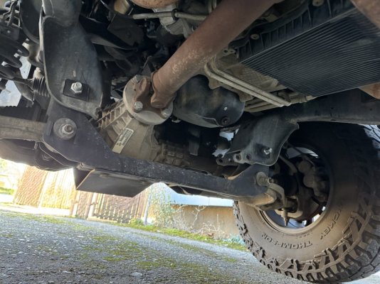

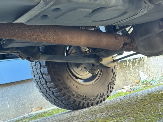

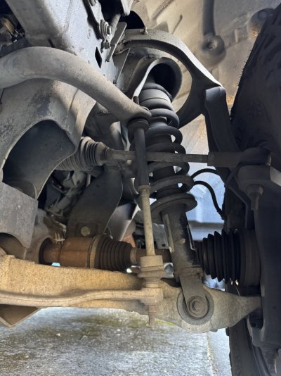

Well its definitely a 4-6” spacer type kit, with spacers over the front struts and drop brackets/extensions.
As to which brand…do the shocks have stickers on them? Any stickers/badging on any other brackets? Are there spacers over/under the rear coils?

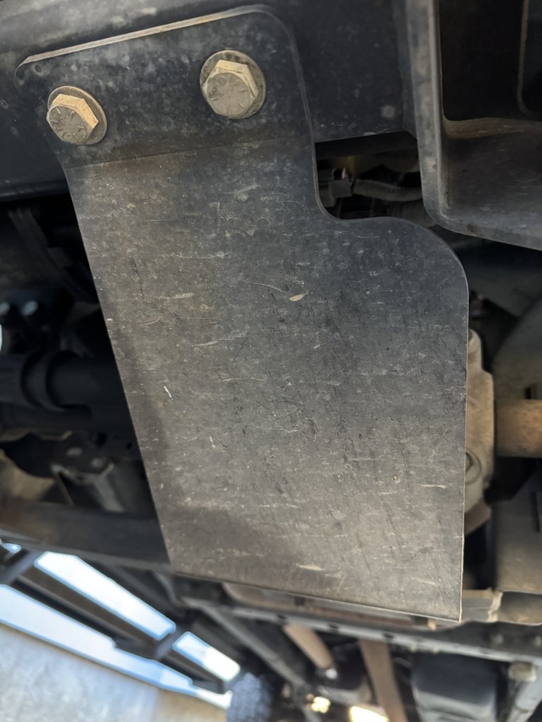

The diff drop cradles and diff skid look a lot like the zone kit.

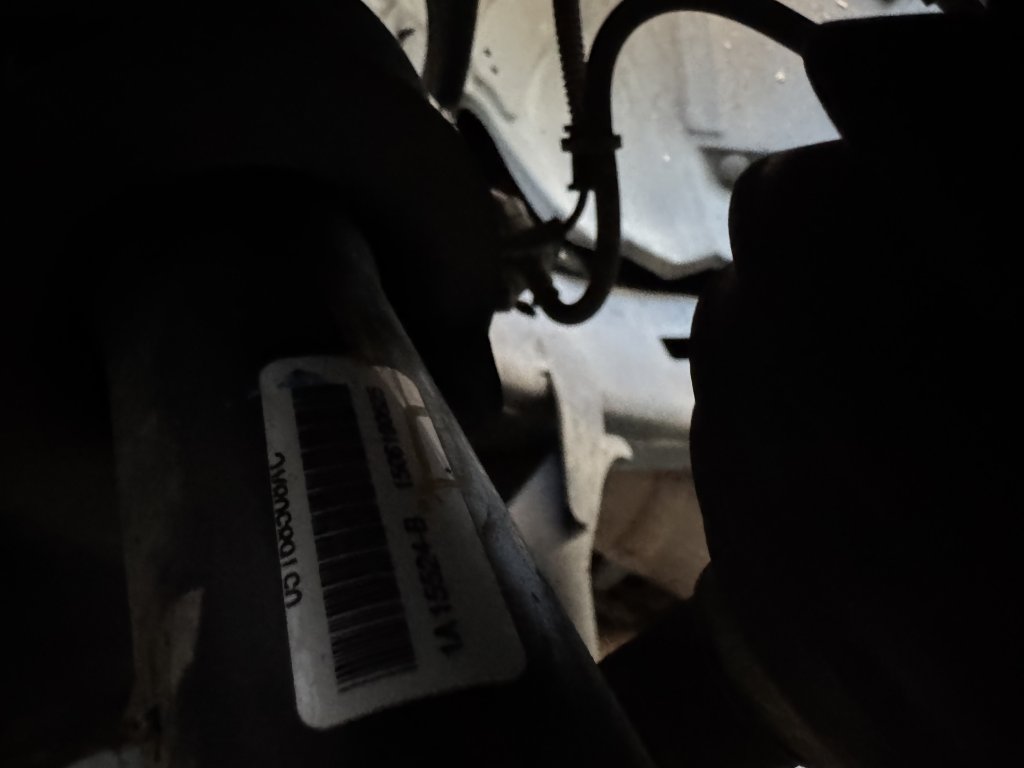

the only label li could find is that one in the picture with the bar code , its a mopar shock , ill have to get back under and check the rears
Yea, the fromt struts are oem units, the lift comes from the spacer on top of them. What brand rear shocks?

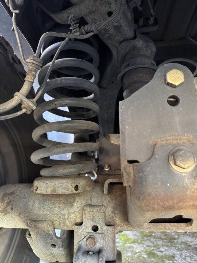

there is no labelling on the shocks at all , probably not the best pics , it looks like there is something , maybe the spacer on top of the spring ?

We were able to work with him and get it figured out. It is a Zone kit with Zone branded rear shocks and OEM struts up front. We got a very nice upgrade shipping out to him real soon.
