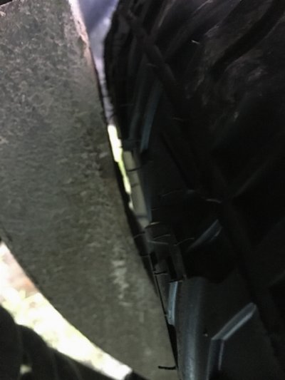

It has to do with the clearances between the stock wheels, and the new knuckle that comes with the lift.
I have a rough country lift on my truck, and am running the factory 20” wheels. Here is a pic showing how close the tire/wheel is to the knuckle, WITH a 1/4” spacer installed.
A 17” rim, with the factory offset, would have the rim and sidewall of the tire rubbing on the knuckle.
I like the factory wheels, so I opted for spacers.
Here’s a pic with 2” spacers installed. Gives a better view of the knuckle shape.
Same 35x12.50 on the same factory 20” rim.

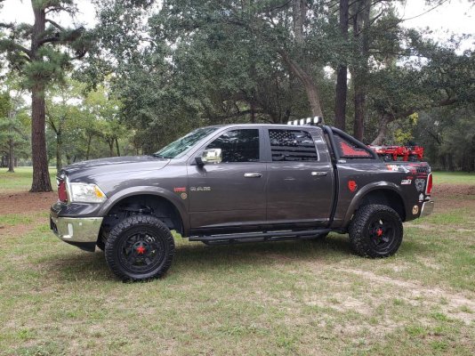

Oh, and third, Zone uses a spacer in the rear if you want 2” of lift, and a new spring if you want 3” of lift ... Depends on the rake you have, the rake you want, and if you wanna add Bils up front for a lil extra lift ... Zone 4”F/3”R with Bils at .7 or 1.4 and 35’s is just about perfect in my book ... Fits in a 7’ garage door, and most parking garages345ea78b13a70e3eb760b05f1f28a340.jpg

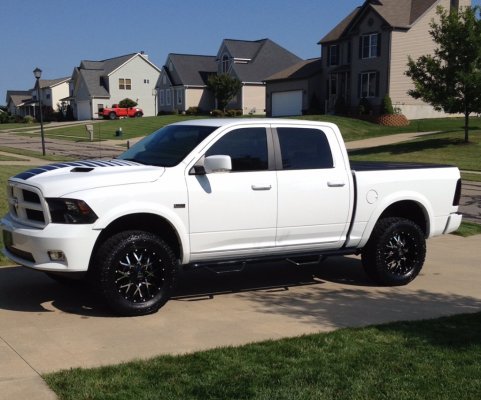

Yeah thanks for aall the info guy's. I've decided to go with a zone offroad kit. Now im not sure if i want a 4 or 6 inch llift. I tried to find some side by sides to compare but no luck
8732cuts
Feb 21, 2018
420
497
US
GO for the 6". Nice height. I had 4" on last truck. 6"on this. I went with rough country. 9aee0d147c22d62f0fa5fbf4f24a20df.jpg
that is about the look that I want. I do want it level so I may do like you suggest and get the Bills up front. how does the truck ride with that set up
BOWERSFJ
Apr 29, 2014
2,713
3,237
Uniontown OH
Smooth, controlled, better than factory ... Not rough in the least ... Get the rear shock upgrade with the kit
