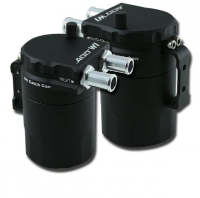

Well I got my Catch Can in today and was able to get it installed.
$36 bucks off Amazon then I bought a better hose and two brass barbs to connect the lines for $5.00 + tax.
Real happy with how its made, feels good and solid and even has a dip stick so you dont haft to pull the can off to check it. figure so long it does not blow up I should be good.
No sticker so not sure how much horse power this one will ad.:crazy:

Wish I would of took pix of the hoses. But it is not hard at all maybe spent 45 mins to a hour doing it.
I mounted it right to the air box so if I change out the air I will have to relocate it. Just takes 2 bolts to mount it.
The hose you tap into is on the passager side of the motor and is a hard line that is attached with 2 small peices of hose, take out the hard line and install the brass barbs in the short hoses and run the new line to the catch can.

I have one with a dip stick as well. Add W1
Quite similar to the one you got, just all black.
Funny enough - I installed it at the air box as well.

It comes out of the back /side of the intake and goes imto the bottom of the throttle body.
