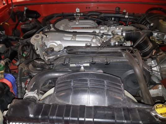

I keep my engines very clean as it makes working on them much easier, and you can spot leaks much better. This is the engine bay on a 1992 4Runner, I wash it at the wand wash, first apply bug and grit soak, then rinse with high pressure spray, being careful where I spray. In the 30 years I have owned it, no issues with doing that.
