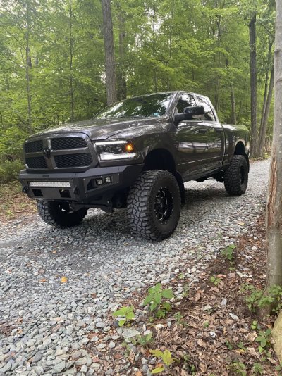

The fox 2.0’s pair very nice with the 6112’s what rear coils do you have the 3 or the 5”

@Freed127 I have a zone 6” with the fox 2.5 full length coil overs if you want to stop down and go for a ride.
great setup! The Zone kit is already great, then add the full length 2.5's and it is a phenomenal setup. @Quick_Shifter knows how to set a truck up!

My truck drives better than it did stock with Fox 2.0's in the back and their 2.5's in the front. I have the Zone 6" lift as well.
^^^^^^Sold by Nick Installed by me "Makes it worth more" LOL
Fox 2.0 Rear shocks for 5" Rear coils part # 98224759
GREAT combo, the lift, the shocks all great quality items that will give excellent drive ability on and off road. Having @Quick_Shifter do the install is the icing on the cake, that man has serious attention to detail and really knows his stuff!
