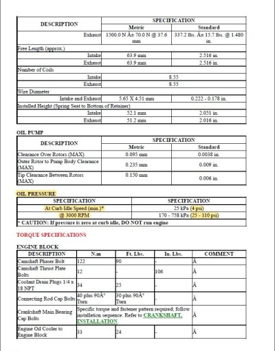

No it isn't, and you can't compare idle stopped to cruising pressures; idle is always gonna be significantly lower. SRT 6.4 hot idle oil pressure is right around 35 psi, little less if I've been flogging it (and they use the same oil pump). It's fine. If it starts to drop closer to 20 psi then it might be cause for concern but technically you would still be within what OEM considers "acceptable".
