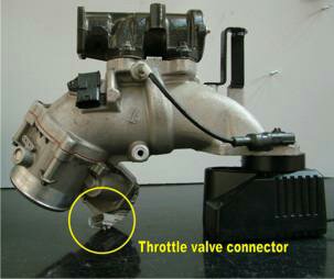

I will see if I can find a pic. On mine it is on the back side of the airhorn/throttle valve assembly NWRQC posted above. It has one of the little red locking tabs that must by slid open before you can unplug it. I was able to unplug mine from above the motor but many say it is easier to reach from underneath the truck.

This is the view from the back side of the airhorn/throttle valve assembly.

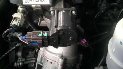

The connector you need to unplug is under the EGR plug with the pink paint on it.
