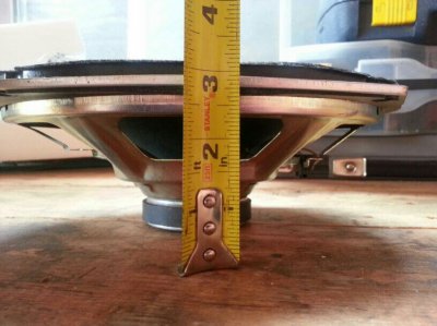

Spacer thickness depends on which speaker you want to install every one has a different mounting depth. Stock ones are 2.75inch
Sent from my SGH-I747M using Tapatalk 4 Beta
