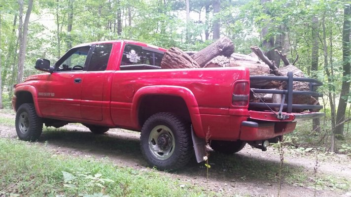

Awesome. Glad it was something easy.
My 99 has 235k on it and still the original starter.
Only non original part is plug wires plugs oil pressure sender and fan.
The truck...just brakes exhaust passenger wheel bearing and u joint multiple times and one driver wheel bearing and I joint. It is due for ball joints...but I do not remember changing them before???
And the fuel pump went at about 145k.
The rest is rust issues. Both rear spring hangers had to be replaced.
Man do I love my V10. It is waiting for a clutch assembly right now...i did have to change the master ***** cylinder also...forgot that2018-03-02 09.59.11.jpg
