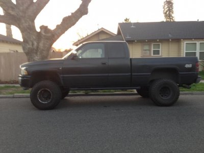

So your saying the 3.55 is not gonna be good at all on my truck? Here is a picture of my truck sitting on the street, not like its much help for this topic but you can see the tires and the lift. i think im gonna chance my luck and look for a case for it at the junk yard and hope that's the best route
