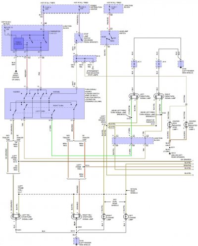

Likely feeding something back. Best just to get a wiring diagram and go one wire at a time until you figure out what you goofed up ;)
There is not that many wires in the factory exterior light circuit, so it's pretty easy to trace.

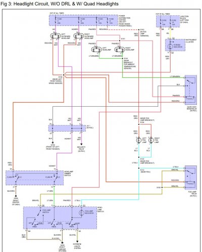

At a minimum these should help you figure out what wire does what and get the truck wiring back working again. As far as alarms and accessory lights, you'll be on your own.
I usually tear that aftermarket stuff out and redo it proper once I get the factory stuff patched up and working 100%.
