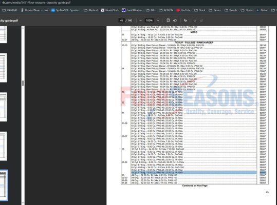

Just a newbie here, not sure if this helps your situation or not, I am getting ready to replace the entire system (Everything) under the hood (including removing the dash and the air handler box and changing out all the doors with my BlendDoorUSA Billet Aluminum Set), but anyhow, hope these help:
