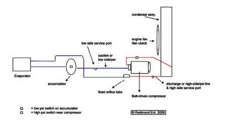

Did you try putting in dye and using a black light to find the leak?
There has to be a blockage somewhere (or something not installed correctly), if the comp, TXV valve filter/dryer and condenser were all replaced. Perhaps the fixed orifice tube is blocked.
Just thinking, if the orifice tube is blocked, the problem is a lot deeper than we think. The inside of an AC is normally as clean as clean can be.
These trucks with YF-1234 use and expansion valve, it's mounted right at the inlet of the evap coil connections. It looks like a block with both liquid and suction connectors and the power element head on one end. Most vehicle use them nowadays.
Getting crud in an expansion valve is worse as at least the orifice tube you can clean, valves not so much.
