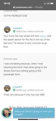

Look n rock auto they sell hubs with 4 wheel abs sensor or for left front with sensors on 2 of the wheels. only rear wheel abs has 1 sensor on left front. I’m not a mechanic just a stupid retired cop.

Why would I need to replace the hubs?
Can’t the sensors be replaced separately? Sounds like a much easier job.

Yes sensor can be replace by itself. I had a hub starting to get some play in it so changed the hub also.
Guess I should have googled it first then I wouldn't be getting schooled by a stupid retired cop.Rear wheel antilock never really worked for **** anyway.That's why other manufacturers got rid of it in 90's.
