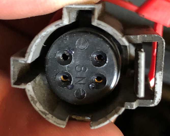

Thanks for your reply.
The high pressure switch connector is a 4 pin connector but only has three wires that connect to it.
I’m tempted to use a paper clip to jump the wires together but I’ afraid if I pick the wrong two wires I may fry something.
Which two wires should I jumper?

Just following up to post the fix. I replaced the pressure switch rather than jumping wires and so forth. Replacing the switch was the fix. I also bought some gauges and charged the ac up myself. Works like a champ now.
