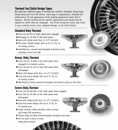

Since I am not doing a lot of hauling or 4-wheeling, I am tempted to put a regular duty, or maybe just heavy duty, fan clutch in to try to improve mileage. Neither is spec'ed for this vehicle, so I'm hesitant. The other choice is to try another manufacturer's severe duty, like a Hayden, but from the posts I've read I'm not sure that a different severe duty clutch would be any different. Any opinions or suggestions would be welcome.

My guess is that the severe duty clutch you have, has very little slip. Meaning that it turns and pulls maximum amount of air at all times (hence the severe duty). I'd throw a standard duty replacement in its place, no need for a heavy duty or severe duty.
That will 100% kill fuel mileage.
Thanks, that is what I have concluded. I have gone from knowing zero to a fair amount about them in the last couple of months.
Given I’m on the second new clutch, and the resoundingly bad reputation of aftermarket clutches (even OEM), I decided to go MOPAR for this item. I’m not even 100% certain I won’t have trouble still, but it seems like the least risky path. I want to move on from this.
It does boggle my mind how such a widely manufactured product can be so prone to defect. It’s not like it’s a new technology.
