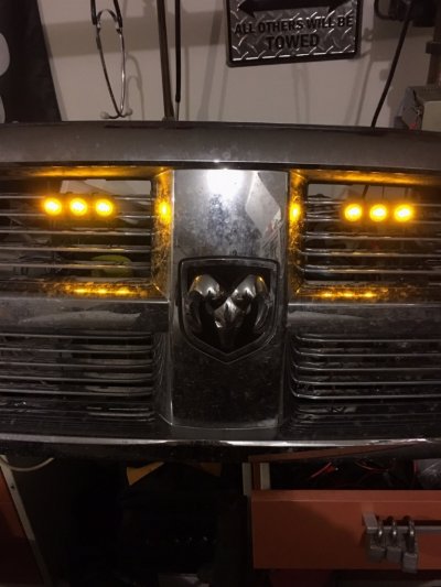

So I have seen a few grills with the Raptor style leds on eBay but did not like the overall look of them. So I made my own. It was pretty simple and might not be for everybody, but I like it and makes my Ram a little different.
Essentially, I had bought ten amber leds off Amazon a while back for a project and never got around to it, so I used them here. Just 3/4” leds, nothing special but surprising bright. Then I grabbed a spare piece of sheet metal I had laying around ($5 piece from Lowe’s I believe) and traced out/cut a stencil that would allow me to mount the leds. Transferred it over to the metal, drilled some holes, threw a coat of black paint on it and called it a day.
B6D44802-6819-4C49-96B5-963BB736A79C.jpeg D464D150-3942-4DCA-B7F2-915D4658212F.jpeg 70861491-5F23-459A-B524-51DAD07BAAB8.jpeg E4CB3874-6FD8-4812-BD90-170976A6ACD0.jpeg
Still need to hook them up to my running light but waiting on my replacement hid to come in so I only have to take my headlight out once. I’ll snap another pic when everything is done.

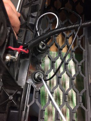

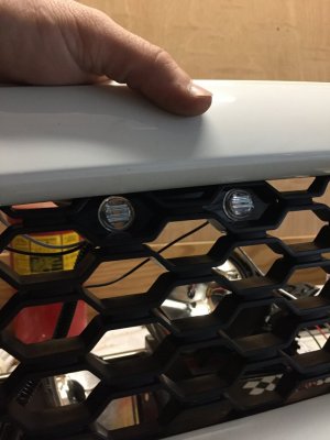

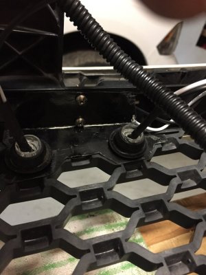

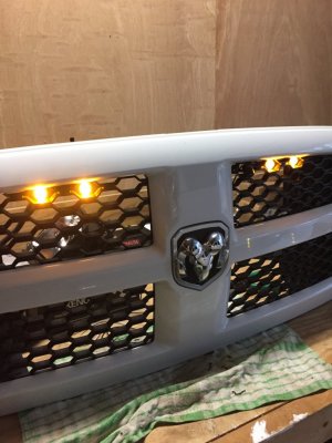

That’s pretty much how I did mine. Think I even have the same LED’s.
You can access the wiring right behind the grill, on the core support without pulling the headlight.
I will say though, I think I’m liking the honeycomb inserts a little more than my chrome slats.
