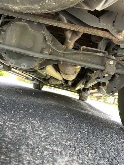

2019 Ram 1500 5.7l CC, 67” bed, 4 x 4. One of the first DT trucks made April 2018. Driveshaft one piece.

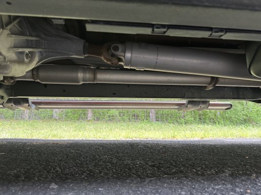

I have a 2022 Crew cab short box and it has a single piece driveshaft.
Mine is a 4x4 too
