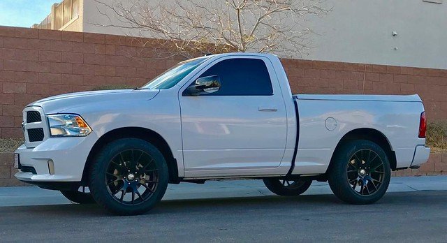

Added wheels/tires, color matched door handles and side mirrors

How hard were the mirror caps to swap

mirrors were pretty easy, swapped to regular painted vs the towing mirrors that came with the truck. Removed the sail panel and door panel, then it was just 3 bolts and 2 wire connectors, a new door switch and respective controllers. Benny supplied all the needed parts. Still have to make it to the dealership to get it programmed for the power folding feature.

I got a tazer for my ram and now the folding mirrors work automatically when I start/stop the truck... pretty cool
Nice! I'll get the program sooner or later, enjoying the new look for now!
