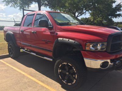

Gathering thoughts and suggestions on idea of ADDING front coil spacers and shackles or add a leaf to my 2005 Dodge Ram 1500 2WD. It currently has Rough Country 3 inch body lift and a Max Trac 7 inch coil suspension lift. I want to make it 12 inches of total lift instead of the current 10 inches that I am at now. I am currently running Radar AT 5 (35x12.5x20). When these tires are done looking to do 38x13.5x20 or 40x13.5x20. Its a daily driver and really do not tow or work out of so redoing rear end (3.92) is not an option now but maybe later. I am sitting at 46 inches from ground to middle of fender. Would like to get to 50 inches from ground to middle of fender.
See some posts from other 2WD owners (pavement pounders) that went this route of adding 2 inch coil spacers (I suppose shock absorber extenders also) and 2 inch shackles (or add a leaf I guess) This got me thinking.
Do I need to consider dropping the drive shaft? Is shackles better than adding a leaf and if so why?

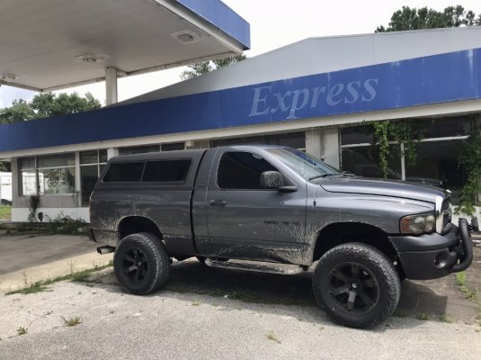

Can you post pics of your set up I have a 2002 2wd with maxtrac 7 and I added new leafs in rear I had to change my driveshaft it was to short and I had a lot of vibrations. I don’t see a problem with you adding shackles in the rear and spacer in the front for more lift I was actually going to do the same but I had already gotten a new driveshaft so I didn’t bother with it

I have the maxtrac so I have 4 spindle and 3.5 coil spring no coil spacer but if you want you can get away with one or two inch spacer def not 3. In my rear I have blocks

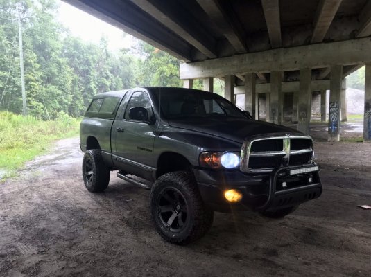

I love the way it looks with your body lift I might look into doing that for some extra height
