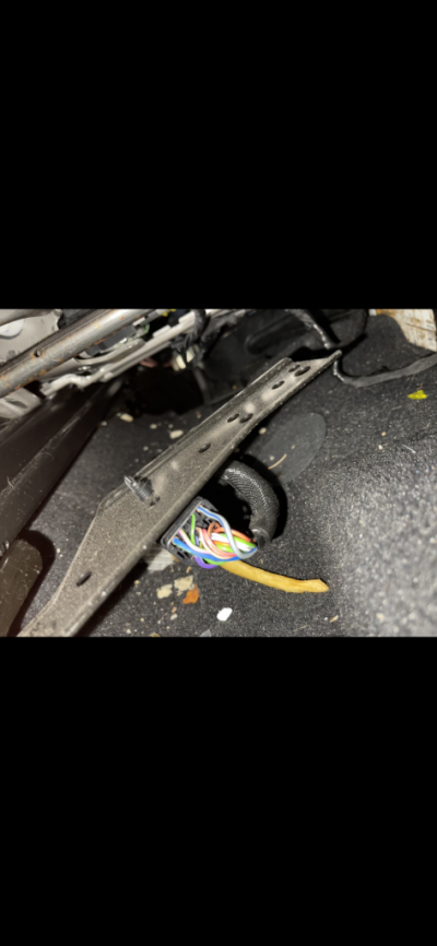

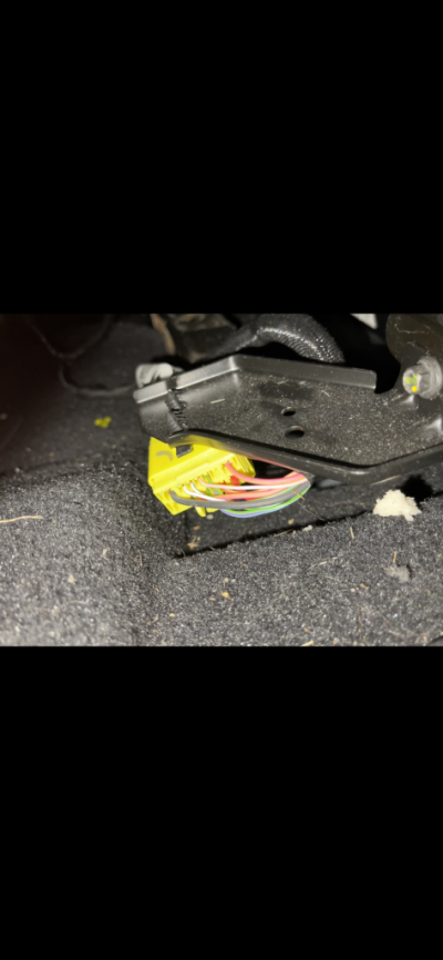

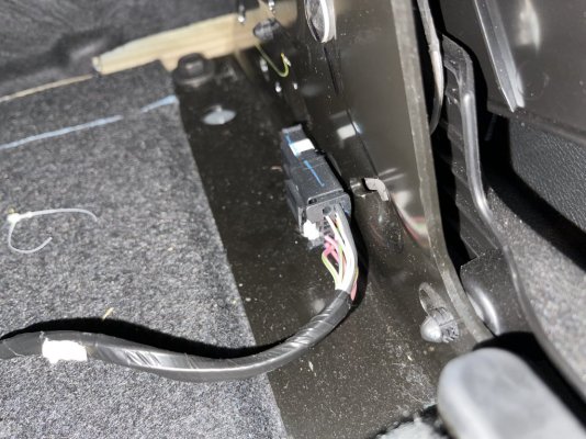

Is the heated seat wiring here? 2019 3500 Big horn. Pics of front and rear are attached

Its hard to tell. The Yellow connector is airbag/restraints related. On the Heated seat module there are 2 connectors that come from the body C1 and C3 , The others come from the seat wiring. I attached a diagram of the HSM as well as C1 and C3
-Benny
