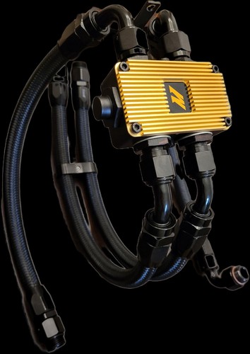

Aftermarket 8hp trans thermostat kit
caulk04
Mar 24, 2013
880
1,550
I have no association with this product, but I'm a fan of it being put together for those who don't want to source the parts or suffer the guess work.
Update 1/3/24 - Garret will be offering my bypass with his kit to eliminate the heater from the circuit. Beyond that mention I'll let him decide how to recommend it's usage with his thermostat kit.

Hey fellas! I'm the seller of the kit Caulk posted (thanks!). @Wild one tipped me off about this thread and asked I pop in.
Happy to answer questions anyone may have. The main ones I've been getting are below along with the updates done to the kit since the first one installed on my personal truck.
Kit Updates:
-Changed the cooler return to thermostat hose end from a 180 swivel to a 90 swivel
-All connections to the factory lines and cooler now use ORB hose ends instead of ORB to AN adapters with AN hose ends. It costs a little more, but this removes (4) components and potential leak points from the design.
FAQ's
1. Will this work with a bypass installed? Short answer is yes. The only downside is longer warmup times but it's not much of a concern unless you live where it regularly gets down to 0 or below in which case you're probably better off keeping the heater functional. I am actually in talks with Caulk to bulk buy his bypass to package with this kit as an installation option.
2. Should I get the 165 or 185 degree option? In most cases I recommend the 165. It will stabilize between 160-180 or about 20 degrees cooler than factory. This is the low end of ZF's recommended temp and I personally like the extra cushion on the high end for if you encounter extreme conditions like a heavy load on a scorching day. Climate and usage is a consideration though: I put together a kit for a gentleman in Alaska and we landed on the 185.
3. Why is it so much? I get this one a lot: You can buy the thermostat for $160 so at first glance the kit is overpriced. However, making it application specific adds up quickly and I have a couple hours of time in assembly, leak testing, packaging, and shipping drop-off. Add in shipping cost and selling fees and I make a lot less than you'd think, but it's a fun side gig for me and I enjoy being able to share knowledge with the community.
4. How hard is the install? Installation instructions are included to make things easier. I usually say the difficulty is about a 4, with 1 being an oil change and 10 being an engine rebuild. The hardest part is getting to and removing the snap ring on the factory thermostat. The rest is a breeze.
5. Do I need anything else for the install? Per the instructions, you need basic tools as well as snap ring pliers and torx sockets. You will also need a quart of ZF or Mopar 8 speed fluid to top the system off.

Welcome abroad Garret. I'm like Caulk04,i think you have a well designed kit,that'll be a good option for guys who don't like their 8 speeds running at 190+ temps.

Okay. Reading through the install instructions a few times, I think I understand now. Without the bypass installed, the transmission will warm up faster.

Correct-o fellas. Utilizing my bypass with the thermostat kit will be a great option, preferred in my opinion.
Using Garrett's thermostat kit will complement my bypass by warming the trans fluid quicker than with my bypass alone. This is the only real drawback with my bypass for those in cold climates.
Using my bypass with Garrett's kit complements by removing coolant heat from the trans fluid completely.

Tim, Rick and Jesse are correct. You can use the bypass as installed meaning you won't even need to get under the truck to install the new kit, except maybe to add the push in zip tie to support the hard lines.
Since you already have it installed I'd recommend leaving it in place and running it. If it's not warming up fast enough for your liking, remove it later but I suspect you will be happy with the outcome and that it will be unnecessary to remove it.

Okay! I installed the thermostat kit tonight. The weather warmed a little so my propane heater was able to keep the garage warm enough to work in comfortably.
I took the rig for a little test drive in 37F ambient temps tonight. The highest transmission temp I saw was 149F. Truck was lightly loaded, which is how I drive it about 98% of the time. I'll have to wait until warmer weather to get to the 165F threshold it appears.
Under similar conditions with just the @caulk04 bypass installed, I wouldn't see temps much above 122F. I still have the bypass installed.
The kit took me about 4 hours to install. I was taking my time and was in no hurry at all.
