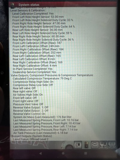

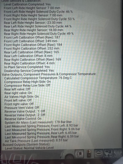

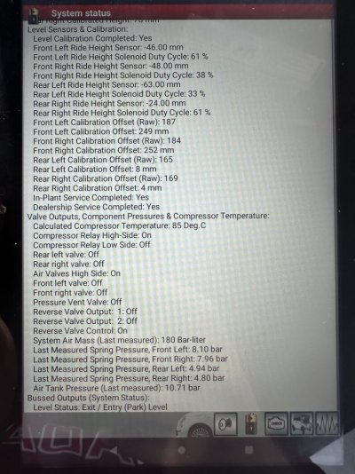

I’ve been noticing lately that my truck is sagging on the rear passenger side. It’s never been past the point seen in the picture.
I figure if its a leak, that corner would be much lower. Maybe when it gets to a certain point, the bag folds over and plugs the leak temporarily.
I ran a scan with AlfaOBD and it shows that bag pressure is about half of the other 3 bags. To me, that indicates a leak. Am I on the right track. I’m thinking I’ll switch over to an AirDelete kit and never worry about it again.

If it were a leak the compressor would continue to run to bring it to the correct ride height. Have you tried running a calibration in Alfa?
I have not tried doing a calibration. Is that done by measuring and re-writing the height values to each bag?
I went for a short drive, then checked the bag pressures at each ride height setting. They seem to be fine after that. But if the truck sits over night, the bag pressure will drop back down to 4.x in the rear right.
