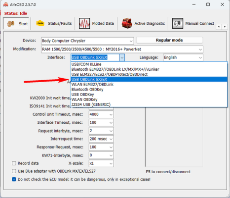

Switch to advance mode (as shown in the pic) and select OBD2 interface device at red arrow. Also check device manager and see if the ODBLink is loaded in USB devices.
