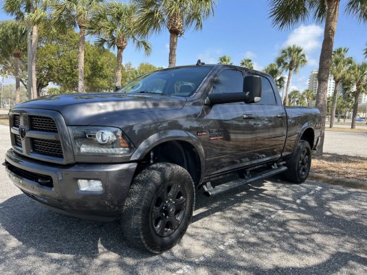

Hi Everyone,
I've been trying to figure out how to do this and have found things very close to this discussed, such as the difference in factory settings (USA vs Canada) for light bulb and parking light brightness.
But, I can't find anyone who's addressed this specifically (I'm sure it's out there but yeah..).
HOW TO QUESTION:
Change the settings of your factory parking light bulbs so they emit brighter yellow light.
From the factory, mine (2016 Ram 2500 Laramie with projector lamps) are around 7.2 volts, I believe..
My hope is that AlphaOBD can be utilized to turn them up to 13 volts.
Any help is SUPER appreciated.. I know others not logging in will appreciate it to..
Thanks in advance!!
Dan

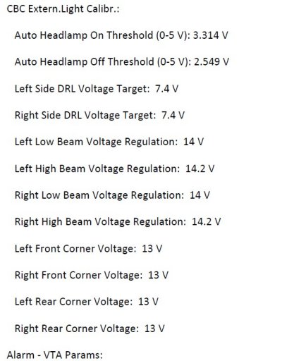

Oddly enough, my '16 had the projector lights and there is no setting for the LED "turn signals" , but there is one for the "DRL" and it says 7.4V. I am guessing the DRL it the normal name for the turn signal LED's.
I have the turns working as DRL's and they are pretty bright.
High beam is 14.2V
low beam is 14.0V
Marker lights are 13V
