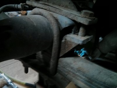

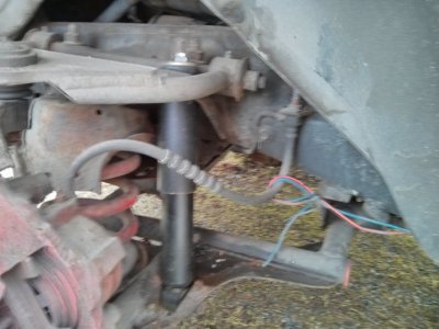

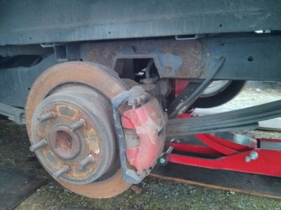

Well I did a belteck 2x4 drop with spindles on my truck. I also removed the helper spring like already said. Removing the spring made no difference in ride quality, its was already crappy. I too didn, t want to do a c notch at the time. But I recentlly purchased another sb 2wd with a DJM 4x6 drop, and this system is way better than the shackle and hanger crap I put on. With the shackle and hangers you lose all the rear wheel travel, meaning the axel hits my custom made bump stops all the time. Very harsh ride, but like I said it wasn,t great before, being a short bed. Heres a pic of the recent purchase front and rear suspention installed by the PO. THis is what I should have done to start with, cause those drop spindles were a lot of money here in Canada. Now don,t get me wrong here, I love the way the 2x4 drop handles the curves now, like it,s on rails.

Can you post more pics of that rear axle? like from the back where leaf spring connect?

Heres another.
