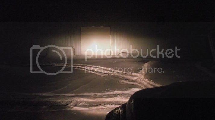

like mentioned, no need for the highs if you don't use them that much, the projector itself when in high beam mode throws a lot of light, heres a quick comparison with the factory projectors with 50W 4300k hid's from jj
low beams
[/URL][/IMG]
highs
