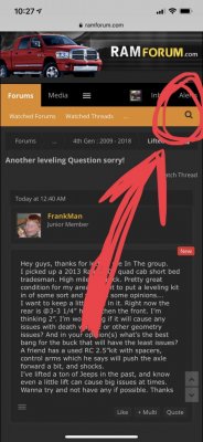

There are at least eleventy billion threads on leveling a 2009-2019 ram 1500 on here throughout the years these trucks have been made on this forum.
I can tell you now the answer you will get is to run Bilstein 5100 @ 2.1

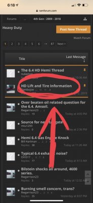

Oh......this, too. It’s practically staring at you!!!
