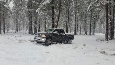

Hi everyone, I have a 2016 2500 Cummins with an open rear diff. The dealership I purchased from said they cannot install the anti spin rear axle and didn't know where to send me. Has anyone had this installed/installed this themselves after purchasing their truck?
